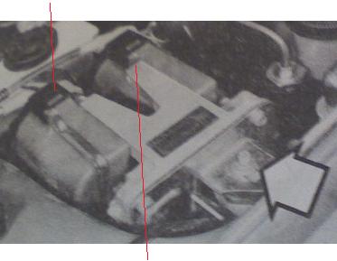

I've replaced plugs, spark wires, battery, and air flow meter. car tries to start smokes a little runs a few seconds than dies. I've checked fuses and tested coils and sensors. What else should I check? What is the firing order wires could be mixed up?

not sure if this will help, but if your running coils, the coil closest to the firewall is a guide for now "T1" now this side will be the front top spark plug the trailing if i remember correctly
https://images.2carpros.com/forum/automotive_pictures/119025_coil_1.jpg
"T2" this side will be the back top spark plug closest to the fire wall again this is a trailing now with the front coil it is the same just check the labeling on the coild should say L1 and L2 same with the trailing coil that i posted a pic of T1 and T2
