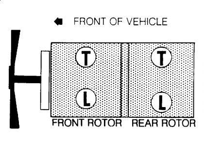

I may have found the problem. When I started this project, the car had sat since 2001. I had to replace the spark plug wires because three of the four wires were broken off at the spark plugs, so I couldn't really see which wires went to which plugs. Its possible I got them mixed up.
Also, Since I last communicated with you, I installed new plugs according to the Haynes manual for this car.
Could you just confirm that the Leading plugs go in the lower spark plug holes (as per Haynes)...and also which wire goes to which plug?

Ok here is the deal there is two coils the leading and trailing. The leading coils have two wires to the primary side and the trailing has 7 wires to the primary side. The firing order is set by the computer by the crank sensor. Here is a pic of where the leading and trailing plugs are on the engine.
https://images.2carpros.com/forum/automotive_pictures/249564_Graphic_141.jpg
