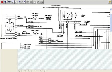

alright i test the fuel pum gave it power with my power probe and it works. but when in the car i just pit a new engine in and now the fuel pump wont get power and the relays and fuses are good. so what could it be why it isnt getting power to it.

Below will help you -Test the COR amd Main relay
https://images.2carpros.com/forum/automotive_pictures/12900_cor_1.jpg
