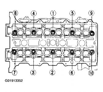

spects. for replaceing head
Jun 21, 2010 at 2:42 PM
BLUELIGHTNIN6
  • 16,542 POSTS
2.0L engine cylinder head bolts tighten to 13 - 16.5 ft. lbs in the sequence below
https://images.2carpros.com/forum/automotive_pictures/261618_Graphic_573.jpg
