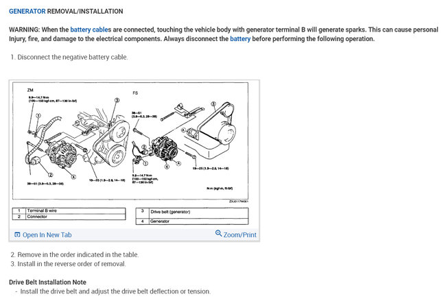

I removed bolt holding alternator , what the best / easiest way to remove it? Plus I need the belt diagrams.
Jul 30, 2010 at 12:18 PM
  • 75,988 POSTS

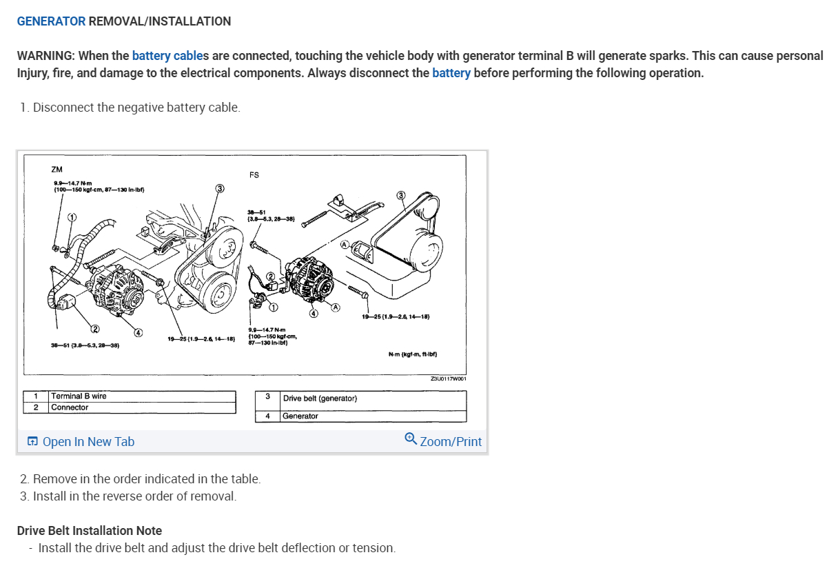

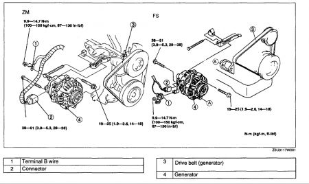

There's no easiest way but the right way-see below: Service and Repair GENERATOR REMOVAL/INSTALLATION WARNING: When the battery cables are connected, touching the vehicle body with generator terminal B will generate sparks. This can cause personal Injury, fire, and damage to the electrical components. Always disconnect the battery before performing the following operation. 1.Disconnect the negative battery cable.
https://images.2carpros.com/forum/automotive_pictures/12900_a_4.jpg
2.Remove in the order indicated in the table. 3.Install in the reverse order of removal. Drive Belt Installation Note *Install the drive belt and adjust the drive belt deflection or tension. Check out the diagrams (Below). Please let us know if you need anything else to get the problem fixed.
Jul 30, 2010 at 2:34 PM
PAH
I have removed the belts, disconnected the electrical leads and removed the upper and lower bolts. The old aleternator is free of its mount but I cannot get it out of the engine compartment from the top or bottom. I tried loosening the AC hoses and gently moving them out of the way but still cannot squeeze it out. Do I have to remove the exhaust pipe?

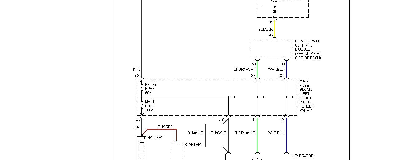

BRINGTWEETY
I have replace the alternator now about 6 times in less then 3 months with also a new battery every time.
Apr 8, 2020 at 10:54 AM (Merged)
  • 110,248 POSTS
Is the voltage regulator part of the alt? How many volts is it putting out?
  • 75,988 POSTS
Could be the computer controlled of the alternator field generation circuit
ELDONGO
offcourse a chip !! I look at the voltage level for both of this alternator wires, blu/whi and gr/whi in a good operating system and it showed .650mv while the alt output was at 14.0v in my car I read 2.4v in the gr/whi and 0.00 out in my whi/blue.
I will check the wiring to the module in the gr and to the instrument cluster charge warning lite for the whi/blue otherwise I will replace the controler board
