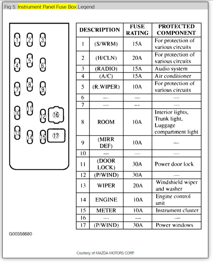

Electrical problem 4 cyl Two Wheel Drive Automatic 97000 miles
After jumper cables were hooked up backwards, a number of fuses were blown. All have been replaced and the car runs fine - everything works except for radio. Radio fuse is fine. Is it fried? Or is there some kind of automatic shutoff?

Hi there,
Start by checking for power at the fuse to make sure the radio is getting power.
Here is a guide to help you see whats going on.

BIGDAWGFAN
I checked the power at the fuse and it is getting power, I think the radio is fried!
I will get an aftermarket one and install it. Thanks for everything guys, I love this site.
