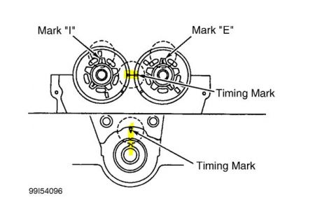

how do I check an see if my car has jumped time
Tuesday, June 8th, 2010 AT 9:03 PM
MHPAUTOS
MECHANIC
31,937 POSTS
With the engine on TDC No 1, the cam timing marks must be aligned, see pic.
