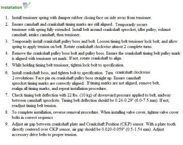

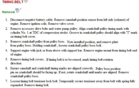

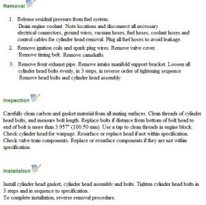

Is it real difficult re replace the head gasket. I've never worked on fuel injection, not surch how hard it would be.

Takes around 7 labor hours to do the job at an experienced shop. Would you like replacement steps to help along the way? Will cost around $400 in repairs at a shop.

Thanks yes I would like replacement steps. That would make it alot simpller.
