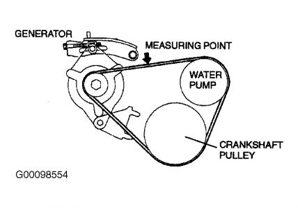

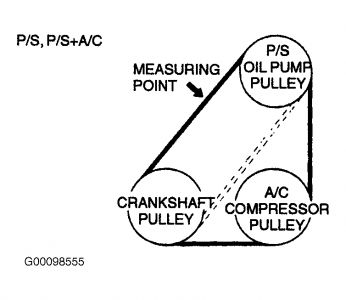

2000 Mazda Protege 4 cyl Two Wheel Drive Automatic
How do I relieve the tension on belt so I can replace?
May 16, 2010 at 11:33 AM
2CARPRO JACK
  • 11,533 POSTS
The first pic shows the tensioner on the alternator, thesecond pic doesnt show one, but Im pretty sure the P/S pump has to be loosened, there should be bolts through slotted holes, these are the ones you want.
https://images.2carpros.com/forum/automotive_pictures/1639_mazda1_4.jpg
https://images.2carpros.com/forum/automotive_pictures/1639_mazda2_3.jpg

you didnt answer my question....How do I replace the belts on my car, what bolts do I undo to release the tension? I made a donation.
May 18, 2010 at 3:44 PM
2CARPRO JACK
  • 11,533 POSTS
you undo the locking bolt on the alternator, then back off the tension bolt as seen in the pic
