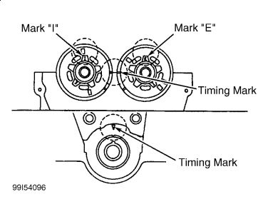

i have a 99 mazda protege i am attempting to replace the timing belt,head,and crank seal do you have a diagram for lineing up the belt and head?

This do it?
https://images.2carpros.com/forum/automotive_pictures/198357_Graphic_378.jpg
