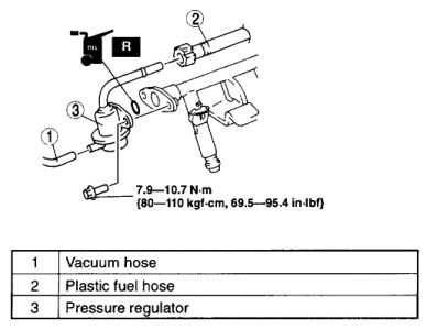

where is the fuel pressure regulator i need to change it

The High Pressure and the Low Pressure Fuel Filters are located in the Fuel Tank on the Fuel Pump Unit, to replace either Fuel Filter you must remove the Fuel Pump from the Fuel Tank. The fuel pressure regulator is at one end of the fuel rail-
https://images.2carpros.com/forum/automotive_pictures/12900_fp_regulator_2.jpg
