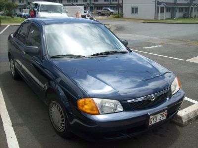

dear carpros my car bogs out going up hill doesn't have that much power but drives wherever i want to go. The engine light sometimes comes on mostly going up hill but then it will turn off after alittle while.
When i put my ac on the car really has no power and dies out. Some people have told me its the fuel filter or the spark plugs I just have no idea help me out please! So I can save time and money!
Thank you[img:2df149767a]http://www.2carpros.com/forum/automotive_pictures/224284_cody1_1.jpg[/img:2df149767a]
