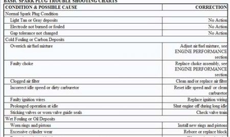

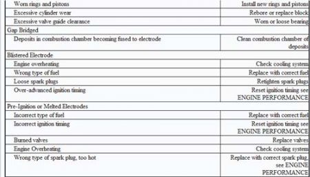

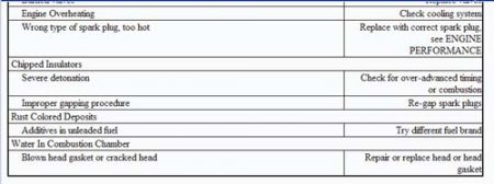

Yes it still has a coil...Follow the high tension lead in the middle of the cap...takes you right to it...Use either a spark tester or modify an old plug and widen the gap to between 1/4 to 3/8th and test all wire, if you get a strong spark at all wires, Look elsewhere for the trouble, test coil this way too...
https://images.2carpros.com/forum/automotive_pictures/62217_Plugs1_1.jpg
https://images.2carpros.com/forum/automotive_pictures/62217_Plugs2_1.jpg
https://images.2carpros.com/forum/automotive_pictures/62217_Plugs3_1.jpg
