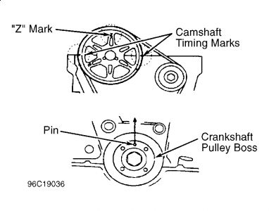

What is the correct alignment of the crankshaft gear and cam shaft gear for installation of the timing belt? Where is the timing mark located on the engine?

https://images.2carpros.com/forum/automotive_pictures/198357_Graphic_372.jpg
