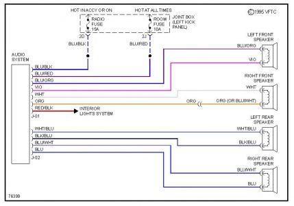

The radio is dead, the fuse is ok. Where do I start checking? The turn signal return switch does not work either and the under hood lamp bulb is out. Any connection? Everything else is working properly.

check flasher and or replace turn signal switch ,, replace underhood bulb ..check both radio fuses
https://images.2carpros.com/forum/automotive_pictures/266999_rad_4.jpg
