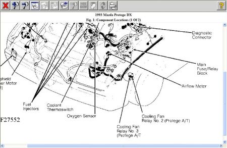

I can't find where the radiator cooling fan switch is located
Aug 22, 2008 at 5:17 AM
  • 75,988 POSTS
If you're talking about the relays -The no.1 relay is in the main fuse/relay box the other 2 -see below
https://images.2carpros.com/forum/automotive_pictures/12900_relay_18.jpg
