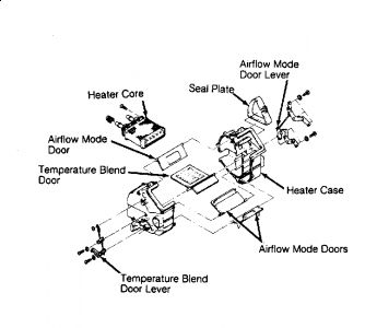

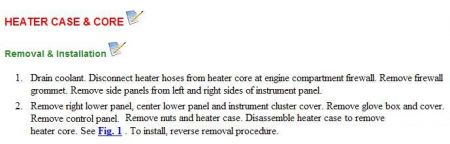

how do you change the heater core on 93 mazda proteger

Hello and thanks for the donation! The replacement procedures are below..
https://images.2carpros.com/forum/automotive_pictures/261618_Noname_1225.jpg
FIG. 1
https://images.2carpros.com/forum/automotive_pictures/261618_Graphic_229.jpg
