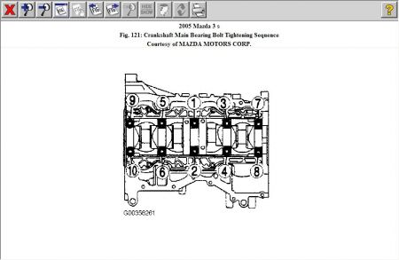

2005 Mazda 3, inline four 2.3, S model
Hi i am in the process of replacing the bottom bearings since Mazda did not honor their warranty. I was wondering if you could tell me what the torqe specifications are on the connecting rods usually theres two sets, you torqe it to the first # then the second #, in a specific order usually from the center out, but i am not sure. Also if i could get the torqe #'s for the main crank bearings also in thier order.
thanks
Vladimir
Dec 5, 2007 at 4:57 PM
  • 75,992 POSTS
Hi and welcome to 2carpros Rod bearings: Step #1 19.2-23.6 Ft Lbs #2 Tighten an additional 80-100 degrees. Main bearings: Step#1 70.9-76.7 Ft Lbs #2 Tighten an additional 175-185 degrees.
