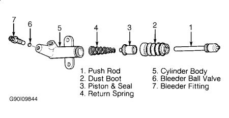

No pressure at the clutch pedal on depression, difficutl to get into gear, stalls in gear
I believe the slave cyclinder has "gone". Is the slave difficult to access in a MAzda Miata?
Whats a reasonable estimate for the repalce memtn of a slave cylinder?

It is bolted to trans easy to remove and replace.Cost for cylinder @ $40. or rebuild cheaper.
https://images.2carpros.com/forum/automotive_pictures/198357_Graphic_112.jpg
