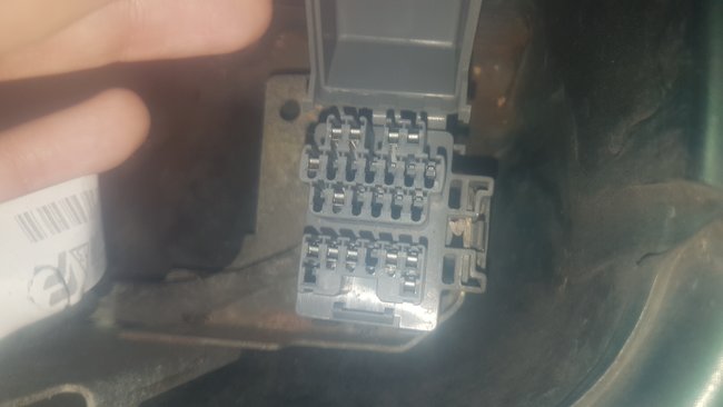

Just to confirm. yes, it's a 323 S BJ (sold in Europe), and manufactured in 2000 with a 17 pin OBD1 in the engine compartment, close to the fuses and battery. :)

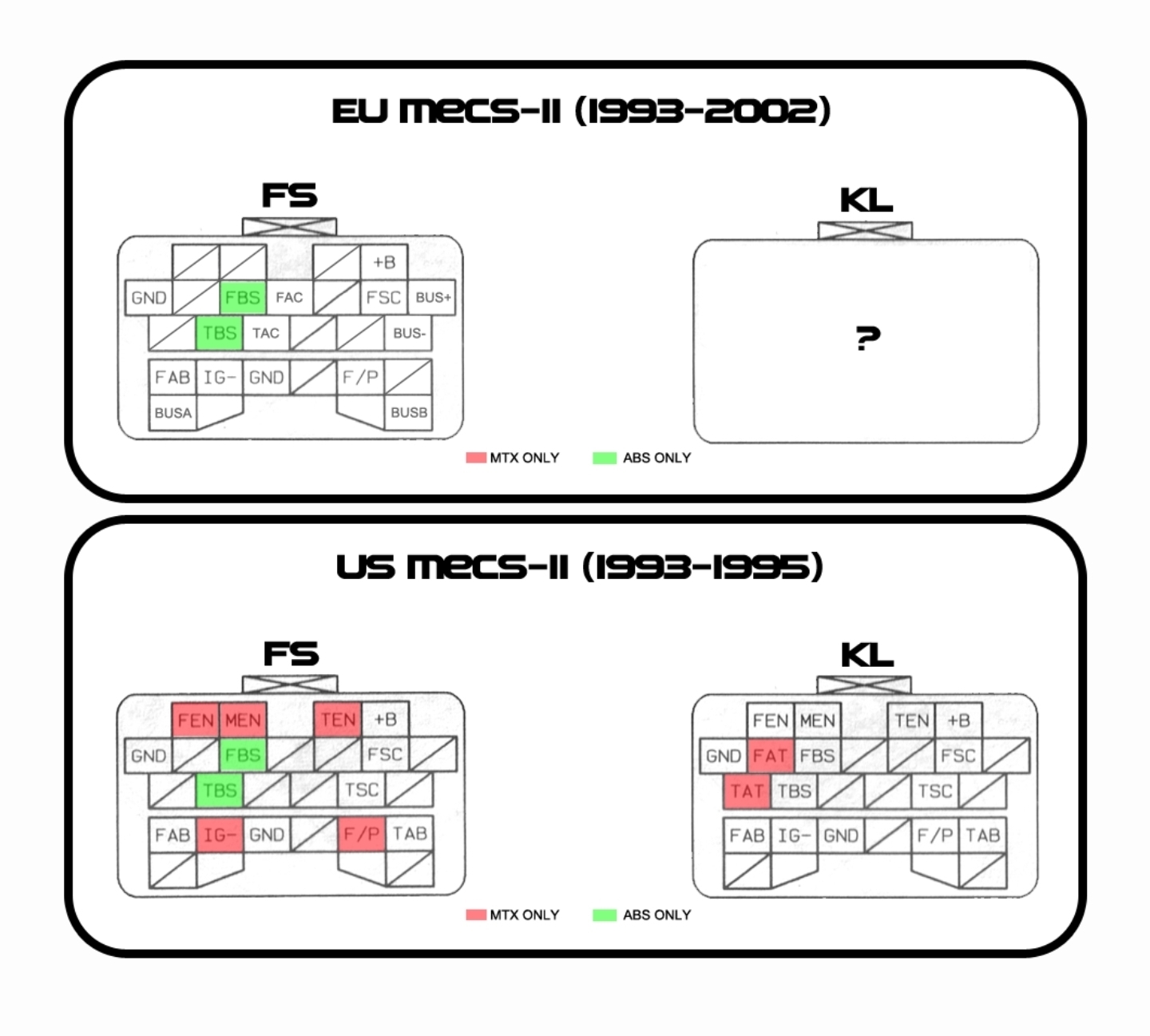

I got around to figuring out, that i had to short TBS and ground to get the abs related reading, in contrary to using TEN.
I get a reading of 1 long, 3 short that keeps repeating

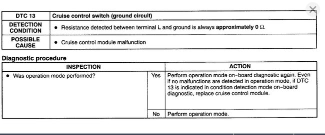

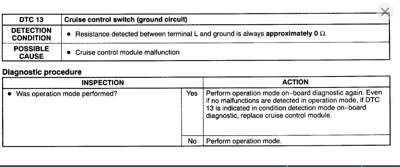

The only code I'm coming up with for a 13 is with the cruise control circuit. Take a look at the pic I attached.
Aug 23, 2019 at 4:52 AM
DANIEL ERNST JONSEN
  • 21 POSTS
My 323 doesn't have cruise control, so i doubt that's the one.

Djdevon3's obd-1 93-95 guide on mazda626 seems to have relatable information, and an ABS error code list that makes sense, in regards to my error 13.
My obd-i port do have a bunch of blanks, but i'm sure enough it's the mecs-ii FS, European and US mixed for some reason.

Wow, that looks totally different than the OBD ports here.

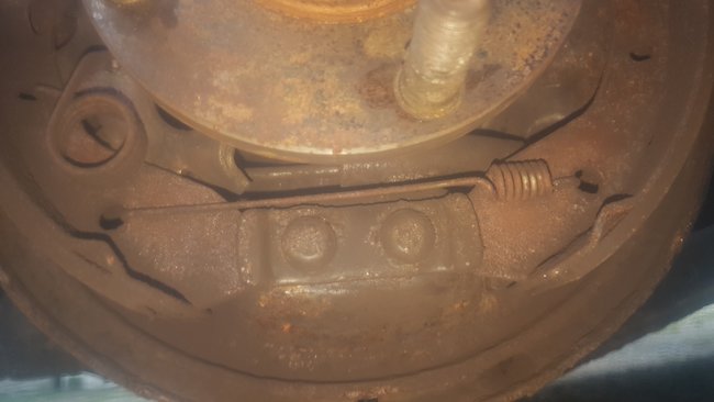

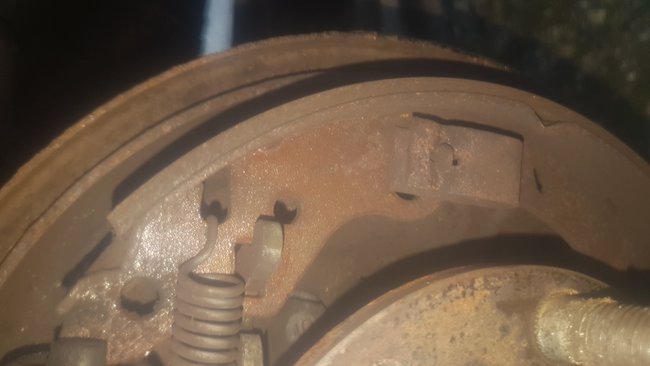

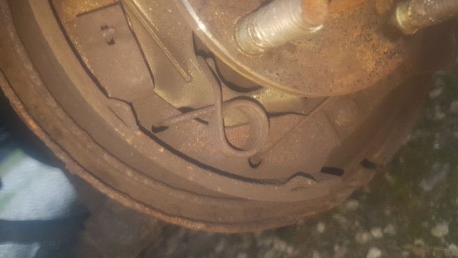

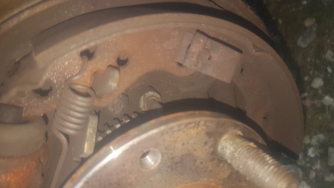

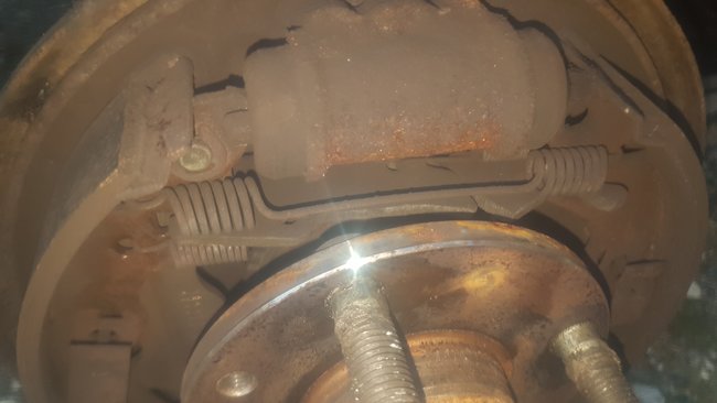

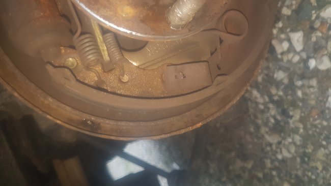

I ended spending half an afternoon getting dirty.
ABS connector is located on the inside, behind the trim, between the seat and back door like the 626 (Protegé as well?), and the drum was pretty straightforward (nicked a bolt keeping abs wire in place, perfect fit for loosening the drum, just like a 2000 Protegé.
I did check the sensor, like in the video you guys made (and mentioned earlier), and i had fine readings - still went ahead and popped the drum, and cleaned a lot of gunk out.
Now, it's a tight fit putting it back together, as the brake shoes are lining up with not much room to spare (wheel does not run free, every rotation or so it gets tight, before and after cleaning).
I'll add a few pictures, to which i hope you can tell if the brake is good or bad (including springs).

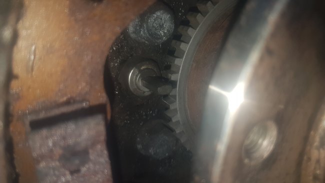

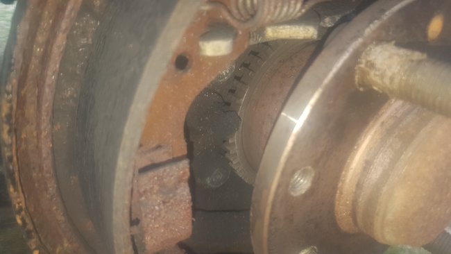

i used a full 500 ml can of brake cleaner for the inside of the drums, springs, reluctor wheel and everything in between, on both sides while cleaning - there may be residual brake dust again since i have been driving, but aside from that i would say i was very thorough on that day (even the brake shoes got a bit of sandpaper). :)
adding a before and after photo, of the rear left sensor (the good one).
a sensor doesn't cost a whole lot, thankfully, but before i can replace it and give another update, i'll need to have the remaining piece of the bolt extracted, which keeps the sensor in place on the rear right (it broke, bleh!).
