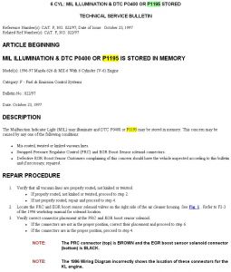

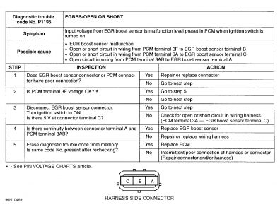

obd II reading P1195 -EGR BOOst/Baro sensor open or short --Can't find anything wrong. Please help

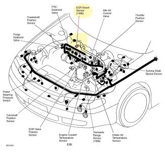

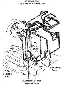

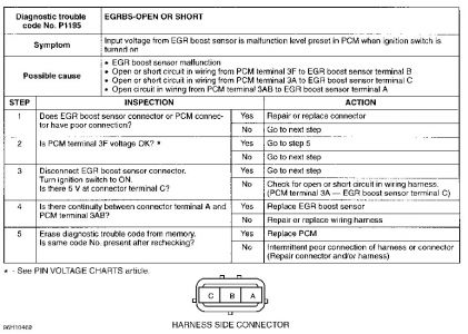

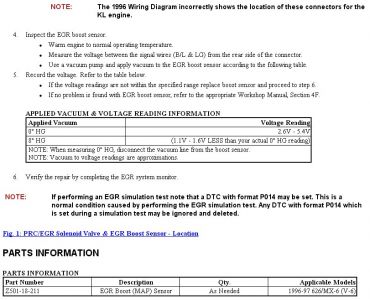

Follow this:
https://images.2carpros.com/forum/automotive_pictures/30961_MX6_1.jpg
There is a technical service bulletin on this also:
https://images.2carpros.com/forum/automotive_pictures/30961_MX6a_1.jpg
https://images.2carpros.com/forum/automotive_pictures/30961_MX6b_1.jpg
https://images.2carpros.com/forum/automotive_pictures/30961_MX6c_1.jpg
If you can't read it , give me you email.
