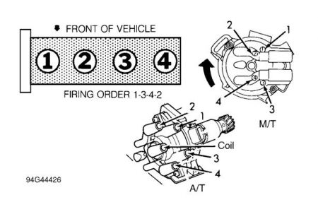

NINEPOPS9
need to know the right order
Apr 10, 2010 at 6:10 PM
  • 75,992 POSTS
https://images.2carpros.com/forum/automotive_pictures/12900_fo_107.jpg

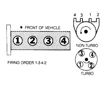

AMANDI0213
1991 Mazda MX6
what order do the sparki plug wires go onto the distruibuter cap

https://images.2carpros.com/forum/automotive_pictures/12900_fo_165.jpg
