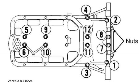

In the manual instructions to pull teh oil pan block, it states there are 2 nuts on one end, I can't find these and so I can't pull the oil pan block nay advice

Hello .. thanks for the donation .. much appreciated You may need to remove the rubber/plastic stopper's from the holes to see the bolt's ....Hope this helps
