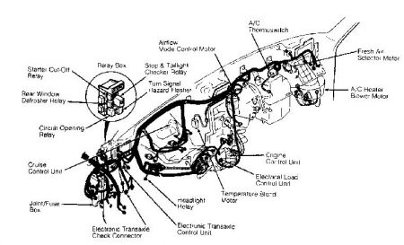

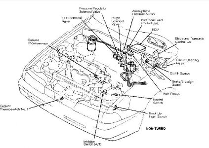

1989 Mazda MX6 4 cyl All Wheel Drive Manual
were could i find the fuel pump relay switch or a fuse for the fuel pump?
Mar 4, 2009 at 1:30 PM
BLUELIGHTNIN6
  • 16,542 POSTS
The circuit opening relays control the fuel pump. There are two located under left side of dash, in fuse/relay box.
