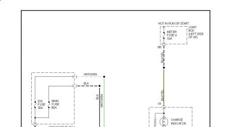

MY ALTERNATOR IN NOT CHARGING THE BATTERY WHEN THE CAR IS ON. THE BATTERY VOLTAGE WHEN CAR IS ON IS ABOUTN 12.7V AT IDLE. BUT IF BATTERY CABLES ARE REMOVED WHEN THE CAR IS ON, THE VOLTAGE ON THE CABLES GO UP TO 14V. WHY IS MY ALTERNATOR NOT CHARGING WHEN I CONNECT THE BATTERY BACK AGAIN?

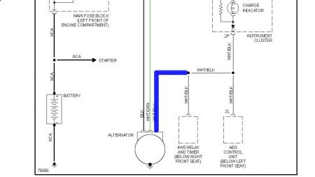

Refer to the charge system EWD
https://images.2carpros.com/forum/automotive_pictures/12900_c1_26.jpg
https://images.2carpros.com/forum/automotive_pictures/12900_c2_24.jpg

POWER CABLE FROM ALTERNATOR TO BATTERY HAS BATTERY VOLTAGE, SO DOES THE WHT/GREEN CABLE...AND WHT/BLACK ONLY GET BATTERY VOLTAGE WHEN THE IGNITION IS ON. MY CAR HAS NO ABS. AND WHAT IS 4WS RELAY AND TIMER UNIT?
