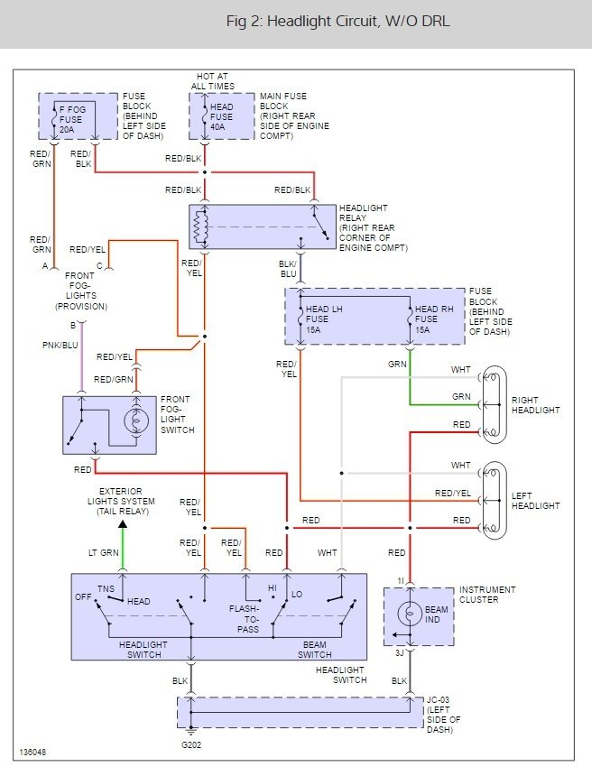

My 2000 maita, mx-5 LS with 56K mi,low beams suddenly quit working! My high beams and parking lights work. I've check both fuse boxes, under the dash and the other under the hood and ther are good! I replaced both bulbs last month. Any advice?

There is a headlight relay that I think has gone out, here is a guide and a wiring diagram that will help you get the problem fixed.
and
Please run some tests and get back to us so we can continue helping you.

Test the headlight relay and its control circuit with a test light; replace the relay if it has failed.
