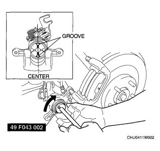

REAR BRAKE CALIPER WHAT IS THE PROCEDURE TO WIND THE PISTON BACK TO FIT NEW PADS

Special tool needed should be able to borrow or rent from parts where you buy pads
