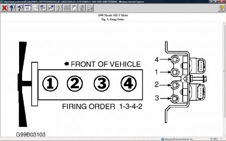

I just put in a new engine on my car. Im having trouble starting the car. Im not sure if I got the firing order right? Can you tell me the firing order?

https://www.2carpros.com/forum/automotive_pictures/62217_FOM_1.jpg
