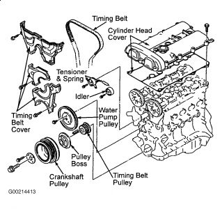

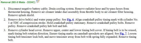

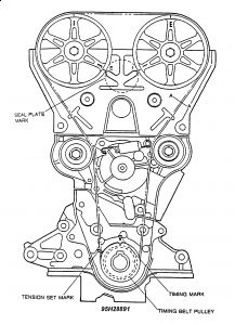

I have a problem about timing and thought you guys could help me. Maybe you guys could help me on how to put back on the timing belt and do the timing corect? Thanks.
Feb 20, 2010 at 5:58 PM
MHPAUTOS
  • 31,937 POSTS
Hi there, See text and pics for timing belt information. Mark (mhpautos)

sorry but i cant really see the writings. Is there any way you could make it BIGGER for me? sorry.
Feb 21, 2010 at 2:19 AM
MHPAUTOS
  • 31,937 POSTS
Hi there,
will try on my new laptop just getting it set up so i hope to post something very soon.
Mark (mhpautos)
Feb 21, 2010 at 3:41 PM
MHPAUTOS
  • 31,937 POSTS
https://images.2carpros.com/forum/automotive_pictures/61395_mazda_text_1.jpg
Hi there i you increase screen resolution (+150) R/Bottom corner of your screen, you should be able to read it if not send me an Email address and i may be able to send a better one that way. mark
