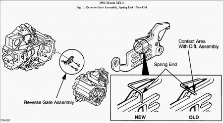

Or this MTX OVERHAUL INFORMATION - REVERSE GATE SPRING CARE TECHNICAL SERVICE BULLETIN Reference Number(s): CAT. J, NO. 003/97,  Date of Issue:   October 23, 1997 Related Ref Number(s): CAT. J, NO. 003/97 ARTICLE BEGINNING MXT OVERHAUL INFORMATION Model(s): 1990-94 Mazda Protege with OHC engine: 1990-94 Mazda 323 with OHC engine: 1995 Mazda Protege: 1992-94 Mazda MX-3: 1993-97 Mazda 626, MX-6 Category: J - Manual Transaxle Bulletin No.: 003/97 Date: October 23, 1997 DESCRIPTION During overhaul the reverse gate spring may be damage or dislodged due to contact between the reverse gate assembly and the differential assembly. See Fig. 1 . Care must be taken during differential assembly installation to prevent contact with the reverse gate assembly. To prevent the spring from dislodging the spring's end configuration has changed. Page 1 of 1 MTX OVERHAUL INFORMATION - REVERSE GATE SPRING CARE -1992 Mazda ...
https://images.2carpros.com/forum/automotive_pictures/62217_MX3c_1.jpg
https://images.2carpros.com/forum/automotive_pictures/62217_mx3_1.jpg
