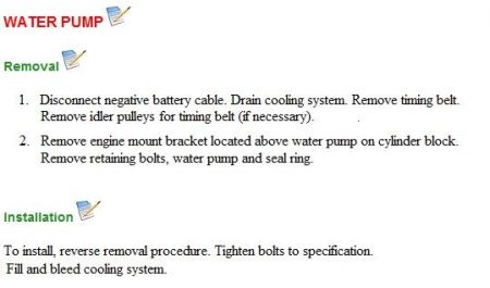

how to change and find water pump

https://images.2carpros.com/forum/automotive_pictures/261618_Noname_2201.jpg
