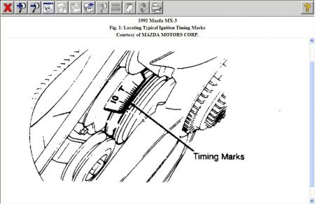

where is the timming marks on the bottom pully

Ignition timing should be 10deg BTDC while TEN and GND jumpered in the check connector Good Luck
https://images.2carpros.com/forum/automotive_pictures/12900_timing_mark_mx3_1.jpg
