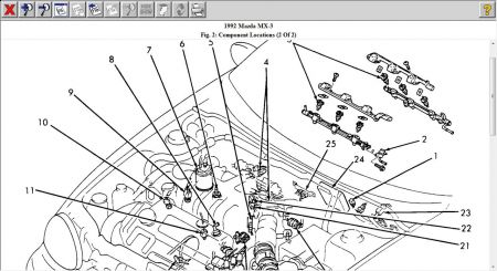

I have a 92 mazda mx3. I have no power to fuel pump or no fire on engine. So far I have changed the fuel pump. {It works when jumped off of diagnostics connector}. I changed Distrubuter, timing belt, crank sensor, PCM, and all relays and cleaned all the grounds. I have no fuel, spark, fuel gauge, or tack. All lights, blinkers, heater, sun roof works fine.

Check all the fuses and Test the main relay and circuit opening relay and get back asap.
Saturday, March 21st, 2009 AT 3:53 AM
636MR MIKE
I checked all fuses and main relay they are all good. Circuit opening also good.
Thank You
Saturday, March 21st, 2009 AT 10:32 AM
636MR MIKE

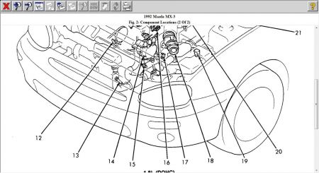

I think a found the main relay and circuir opening relay. Do you know where the are located to be sure I found them.
Thanks again
Saturday, March 21st, 2009 AT 10:46 AM
  • 75,992 POSTS
No.1 is the COR
https://www.2carpros.com/forum/automotive_pictures/12900_cor_3.jpg
No.19 main relay
https://www.2carpros.com/forum/automotive_pictures/12900_main_relay_1.jpg
This 2 relays together powers the coil/injectors/fuel pump
