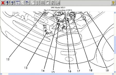

If anyone could help I'd appreciate it as I need to get this going. I did ask the same question and made a donation first thing this morning but have not heard anything back.
I tuned up my daughters car yesterday re rough idle. I did plugs, rotor and cap. After completion it fired up and ran beautifully for about a minute then stopped and wouldn't start. I traced back to no spark from the coil and replaced it. Again no spark. This morning I went out and tried it and it started right up, ran until I hit the throttle and stopped and would not re start. Again no spark from the coil although the large feed wire had power. I also noticed this morning that there was no smell of fuel. I pulled off the fuel line from the inlet of the filter and turned the key on but no fuel.
I'm an old 70's guy so anything computer confuses me. my question is, is there a system that will shot down both power to the fuel pump (electric) and prevent spark. Any suggestions would be appreciated. I'm at a loss.

Sir-I need you to check the red and white wire at the injectors harness connector for power turn ignitio switch On-tell me if you have it. This is important we are dealing with 2 relays the ECM and COR relays-also the blue wire at positive coil terminal. I need to know this before we can continue. I'll be waiting

Hi, Went out at first light this morning and it did the same thing, Fired and ran for about ten seconds then quit. Same thing if I put it in "N". Both wires you mentioned have power.

Craig Test/replace the engine main relay and the circuit opening relay or swap with a like one and see what happens- Also inspect and test the crank angle sensors-1 is in the distributor assemblyand the other is on the bottom of the crank pulley. See pic below item 12 and 14
https://images.2carpros.com/forum/automotive_pictures/12900_cc_sensors_1.jpg
The circuit opening relay powers the fuel pump -when the main relay powers it
