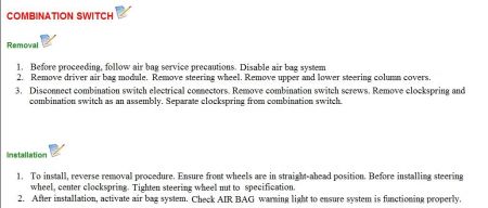

The entire dimmer, headlight, turn signal combination switch will have to be replaced.
https://images.2carpros.com/forum/automotive_pictures/261618_Noname_2823.jpg
https://images.2carpros.com/forum/automotive_pictures/261618_1_205.jpg
