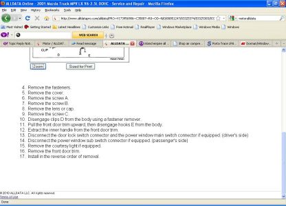

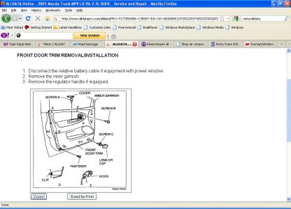

https://images.2carpros.com/forum/automotive_pictures/416332_2001_mazda_mpv_lx_part1_1.jpg
https://images.2carpros.com/forum/automotive_pictures/416332_2001_mazda_mpv_lx_part2_1.jpg
Sorry about that i posted the instruction's for removing the door panel.I think it's the motor but i want you to take the door panel off when it's not working and test for power to the motor when you move the switch up and down position.If you found the power regulator assembly with the motor for 95 and it turn's out to be the motor i would just replace it with that.You have one of those cable operated window regulators they get brittle and break so better to just change it all.I saw just the motor for 99 so if you can get the regulator with for less then i would go that route.Let me know what you find.

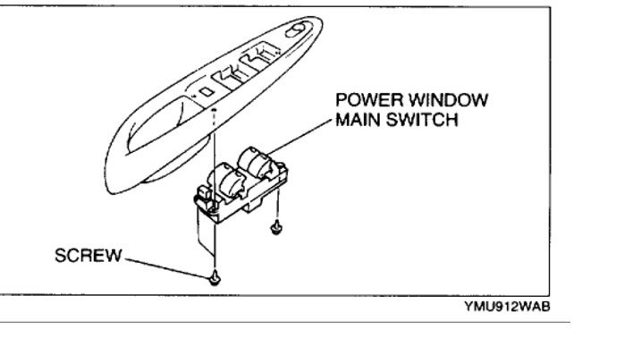

My wife rolled down the pass side sliding door window, and all the window controls stopped working, even the switches on the pass side. I checked ALL fuses and they are all fine.
Also, on the driver door window controls, the driver window button makes a buzzing sound when pressed. I removed the switch module and the sound is coming from the two small square modules mounted on the switch board. This sound only happens for the driver window switch.
I pulled the pass side sliding door panel and wired 12v to the motor to get the window back up (rain was coming), but am at a loss on what to do now.
Thanks for any and all help!
Adam
Jul 7, 2017 at 6:07 PM (Merged)
  • 54,840 POSTS
It sounds like the main switch has failed which is where all of the windows get their power from.
Here is a guide that will help you get the problem fixed.
https://www.2carpros.com/articles/electric-window-repair
Here is a diagram (below) of what it is on your car.
