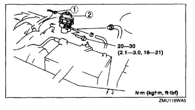

how hard it is to change this valve?

Here is a test video to see if the valve is bad once you get it off.
https://youtu.be/DqUCbbKdWf4
EGR VALVE REMOVAL/INSTALLATION
1.Disconnect the negative battery cable.
2.Remove the air cleaner.
3.Disconnect the vacuum hose.
4.Disconnect the EGR pipe.
5.Remove in the order indicated below.
1.EGR valve connector
2.EGR pipe
3.EGR valve
6.Install in the reverse order of removal.
7.Connect the negative battery cable.
