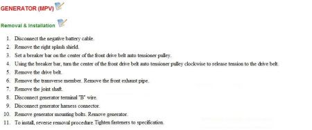

do you have to remove axle to replace alternator?

https://images.2carpros.com/forum/automotive_pictures/261618_Noname_1842.jpg
