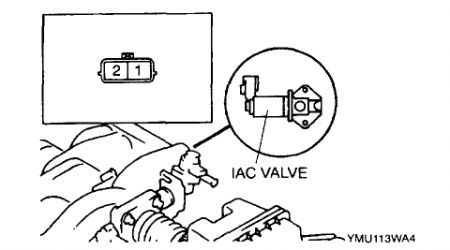

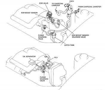

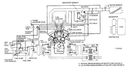

Can you provide a diagram or way for me to see the locations of these valves? They have never been replaced or serviced. When the van is cold and I start it, sometimes there is a loud hum coming from the air cleaner housing, but it warms up pretty well. When I get to the first stop or two, the engine idles a little rough. However, when the van is warmed up, it runs perfectly...help!

Hello - If you do need to get back with me please let me know if your model is a DX, ES, or LX. Also is your engine size the 2.5L? I have provided the info I believe you need. For the hum.....it may be your IAC. There is a TSB out on this....I have attached that info and other info on the IAC. Next the PCV....the location and check of that.......it should be inspected every 60,000 miles. Me, I would change it as they are not that much.....preventive maintenance I call it. EGR.....I have attached a check for it.....the other check you need test equipment and the information on it. Then some other sensor info IAC information IDLE AIR CONTROL (IAC) VALVE INSPECTION Resistance Inspection Disconnect the negative battery cable. Disconnect the IAC valve connector.
https://images.2carpros.com/forum/automotive_pictures/248015_IAC3_1.jpg
Measure the resistance between the IAC valve terminals using an ohmmeter. If not as specified, replace the IAC valve. Intake Manifold; Service and Repair. If as specified but the Simulation Test is failed, carry out the "Circuit Open/Short Inspection". Resistance: 8.64 - 10.56 ohms More Info IAC

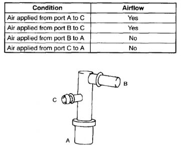

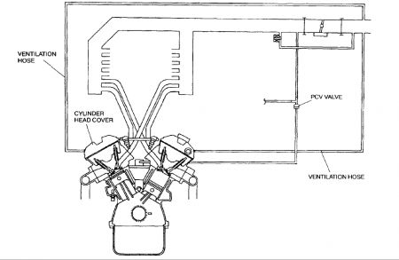

PCV Information
https://images.2carpros.com/forum/automotive_pictures/248015_PCV1_1.jpg
https://images.2carpros.com/forum/automotive_pictures/248015_PCV2_1.jpg

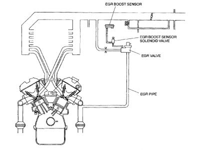

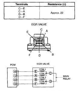

Remove the PCV valve. Blow through the valve and verify that air flows as specified. If not as specified, replace the PCV valve. EGR Information Testing and Inspection Notes On-vehicle Inspection Carry out the "EGR Control Inspection". If not as specified, perform the following inspection of the EGR valve. Resistance Inspection NOTE: Perform the following test only when directed. Disconnect the negative battery cable.
https://images.2carpros.com/forum/automotive_pictures/248015_EGR3_1.jpg
Inspect resistance of the EGR valve coils. If not as specified, replace the EGR valve. If as specified but the "EGR Control Inspection" failed, inspect the vacuum hoses for improper routing, kinks or leakage, and inspect "Circuit Open/Short Inspection".
https://images.2carpros.com/forum/automotive_pictures/248015_EGR1_1.jpg
https://images.2carpros.com/forum/automotive_pictures/248015_EGR2_1.jpg

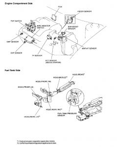

Other Sensor Info
https://images.2carpros.com/forum/automotive_pictures/248015_Sensors1_1.jpg
