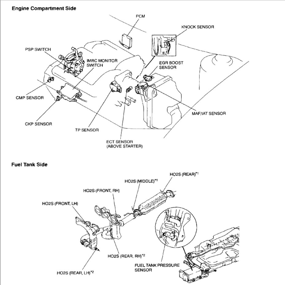

Where is the map sensor located can you tell me please? I love this site
Apr 9, 2010 at 6:51 AM
  • 55,423 POSTS
Your car has a mass air flow sensor not a MAP sensor. The MAF is located at the throttle body at the front of the intake manifold. Here is a guide to help you get the part replaced.
https://www.2carpros.com/articles/how-to-replace-a-mass-air-flow-sensor-maf
Here is a diagram to show you the location (below)

I want to know the location of the map sensor.

Hello !!
The MPV doesn`t use map Sensor...
I think it uses MAF Sensor..
What is your car problem?
Symptoms?
Let us know!
We will be happy to assist you!
