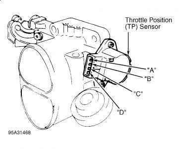

OK coolant sensor probably isn't the problem. It is off but only by 10 degree's so I don't think this will cause your problem. Now I would like to test the TPS. What you will do is check resistance between term C and D. Now you will also need a feeler guage. With .006 you should have continuity between those terms. Now with .020 you shouldn't have continuity. let me know what you find. Here is a pic so you know which term is which.

SOULSHAKER
  • 6 POSTS
Resistance on term. c&d .006 = 3.38, .020=3.32 on 20k scale. On term a&b .006=0, .020= open.
