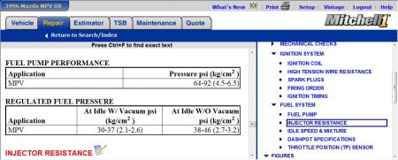

I have this van 1996 mazda mpv it acted like it had a bad fuel pump. I installed a new pump but that didn't help. It runs good cold but as it warms up it starts dying if you hold it steady the rpm's fluctuate. If you try to drive it it dies on you. It give no codes. Can you help?

Check the fuel pressure with a gauge and comeback with the readings we start here.

45 lbs. could it be the map sensor causeing the problem?

The fuel pressure should be as follows-see below
https://images.2carpros.com/forum/automotive_pictures/12900_fuel_pressure_11.jpg
