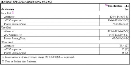

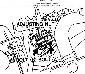

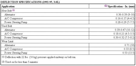

the belt that connects the alternator and waterpump keeps breaking. what are the specifications to replace this again ie. tension of belt possibly.

ALTERNATOR Loosen alternator bolts and adjust belt deflection by turning adjusting bolt. See Fig. 1 or Fig. 2 . Adjust tension. See Fig. 8 or Fig. 12 . See ADJUSTMENT SPECIFICATIONS . Tighten bolts to specification. See TORQUE SPECIFICATIONS . Check pulleys for binding by spinning them, a bearing or burr on the pulley should be fixed!
https://images.2carpros.com/forum/automotive_pictures/62217_30_1.jpg
https://images.2carpros.com/forum/automotive_pictures/62217_deflection30_1.jpg
https://images.2carpros.com/forum/automotive_pictures/62217_tension30_1.jpg
https://images.2carpros.com/forum/automotive_pictures/62217_tspec_1.jpg
