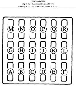

On some occasions when I go and start engine it starts right up but when Itry to put shift in drive it does not move and 15amp fuse is blown. when fuse is replaced it is ok till next time. mechanic took steering columm apart and everything seems ok including solenoid.
appears that this paticular fuse is connected to
several other componets odometer ,shifting instrument cluster lights. Does the transmission have any internal
electrical componets that might be blowing fuse
Thanks

What is the fuse that is blowing? Can you provide the location and description?

fuse box located interior of vehicle under dash on left side.
fuse is for meter

Our database does not provide the actual description of the fuse so can you please indicate which fuse from the diagram?

the fuse location is letter I I have been using the vehicle the past week and it has not blown. the fuse is labeled meter which controls the instrument cluster and cruise control

The fuse powers the followings and any of them could be the cause .
1. Instrument cluster.
2. 4GR off switch
3. Shift Lock Solenoid Valve
4. Door Lock Timer Unit
5. Cruise Control Unit
6. Diagnostic Module
Since the fuse is not blowing now, it would not be possible to locate the source. It could ba a bare wire somewhere causing the problem intermittently.

fuse is blowing more frequently. I now notice that when
you start vehicle and then place automatic shift lever from park to reverse it is blowing the fuse.
I did place lever into neutral then put in a new fuse.
i then place lever into drive and their was no problem.
It seems that only when I shift from park into reverse that it is blowing the fuse

As fuse is only blowing when shifting out of park, the component likely to cause that would be the interlock solenoid valve. Check if the solenoid is clicking onto bare wires that had been caught in between.
