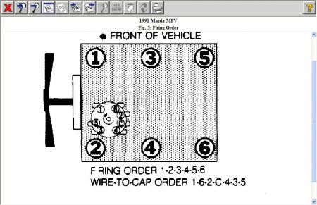

i unplug all the wires cable by mistike end i need the numbers to the rotor cap
Dec 2, 2008 at 7:43 PM
  • 75,992 POSTS
Here you go
https://images.2carpros.com/forum/automotive_pictures/12900_fo_27.jpg
