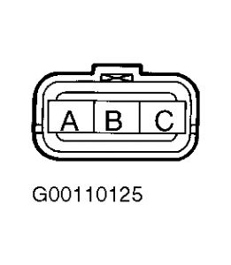

Would not start 5 minuets after just running. Shows no spark. Cant,hear fuel pump running prior to ignition. plugs are dry. turns over fine. Can't find emergency fuel pump shut off. Would fuel pump not running cause engine control to disable spark? All fuses - relays are good.
updated 9/4/09
OK: Where is that component (CKP) located in the engine compartment so I can check it? Brad
Sep 3, 2009 at 2:00 AM
BMRFIXIT
  • 19,053 POSTS
check for any DTC codes suspect bad crank position sensor CRANKSHAFT POSITION (CKP) SENSOR RESISTANCE Millenia 2.5L 520-580 Measure resistance between sensor terminals "A" and "B".

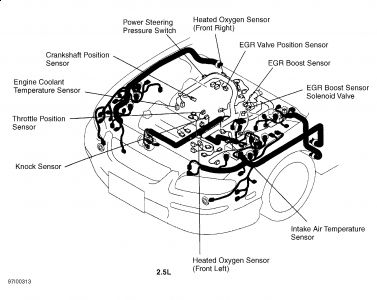

OK: Sounds good. Where is that component (CKP) located in the engine compartment so I can check it ? Brad Strode
Sep 4, 2009 at 8:32 AM
BMRFIXIT
  • 19,053 POSTS
Crankshaft Position Sensor (2.5L)located On front of engine.
https://images.2carpros.com/forum/automotive_pictures/99387_Graphic1_488.jpg
Sep 4, 2009 at 9:30 AM
BRAD STRODE

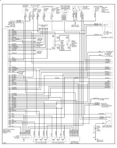

I think I found the wiring harness plug in the schematic of the engine compartment. Isn't the actual sensor just above the oil filter. I had to order it and won't be here till Tues. due to holiday. Thought I would check the fuel pump relay im between and can not find info on which unmarked relay it is. Not listed in owners manual or by Autozone as per location in under hood box. One more favor. Which one is it and do I check on a four pin relay for voltage or for continuity. Relay is $75.00 and I would have to order what I can't find? Thank you so much for all of your help. Enjoy your weekend.
Brad Strode
Sep 5, 2009 at 10:13 AM
BMRFIXIT
  • 19,053 POSTS
sorry dont have pic of the relays and location but you can mark them and switch around for a quick check this is the wiring for the relay too LTGrn/red feed from the PCM red/black feed from the main relay blk/wht feed from the fuses yel to fuel pump
