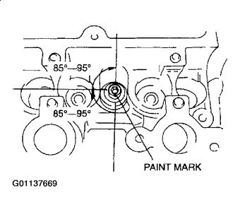

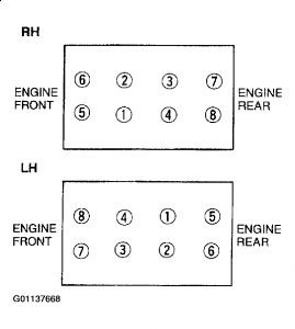

i need to know the torque sequence of the cylnder head
Friday, April 16th, 2010 AT 1:49 PM
DOCFIXIT
MECHANIC
18,828 POSTS
Torque to 17-19.1 ft. lbs
Then turn bolts 85-90 degrees
