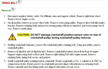

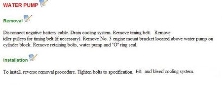

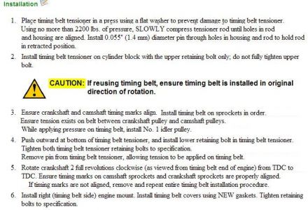

How to Replace the Timing Belt and water pump.
