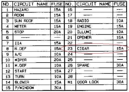

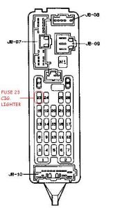

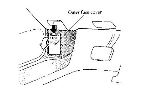

I need help locating the fuse for the cigarette lighter. It is not included in the typical group of fuses under the hood, not by name anyway. It might be powered by another source but none of the fuses were blown. Am I missing an "in line" fuse somewhere?
Thanks!
David
Dec 18, 2008 at 10:56 PM
BLUELIGHTNIN6
  • 16,542 POSTS
Hello Thanks for the donation Below is the info. you requested. Inside joint box, located on under driver's side of instrument panel and behind kick panel.
