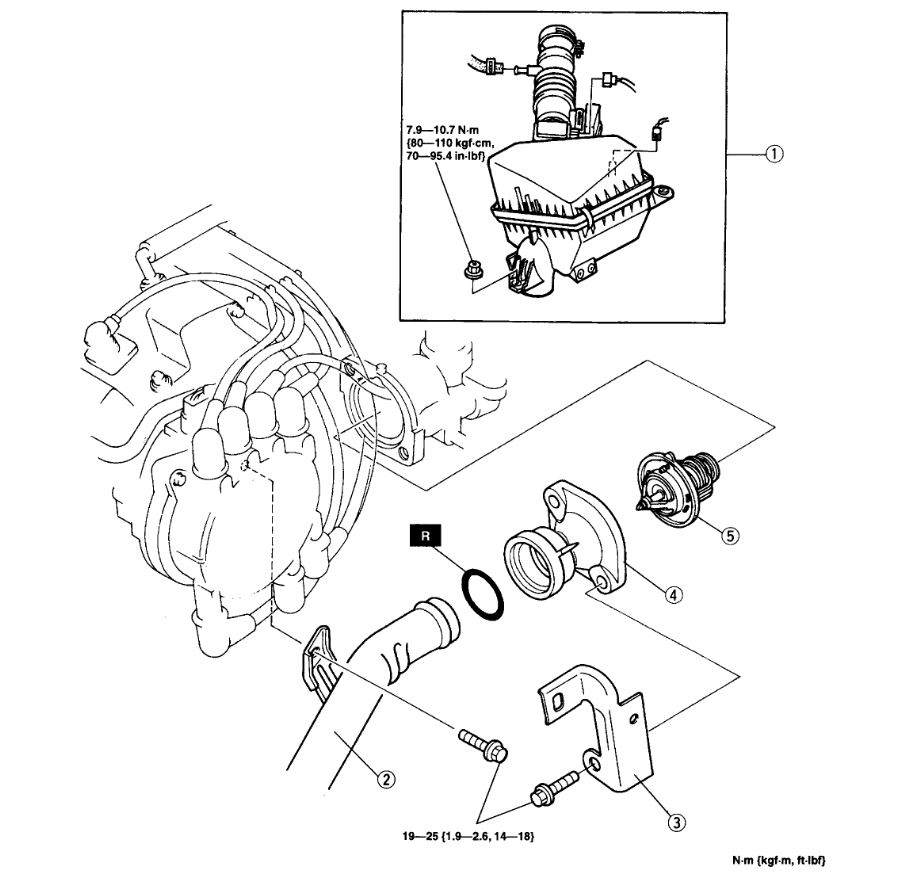

Where is the thermostat located on 95 Millenia?
WHEATMAN1367
MEMBER
1995 MAZDA MILLENIA

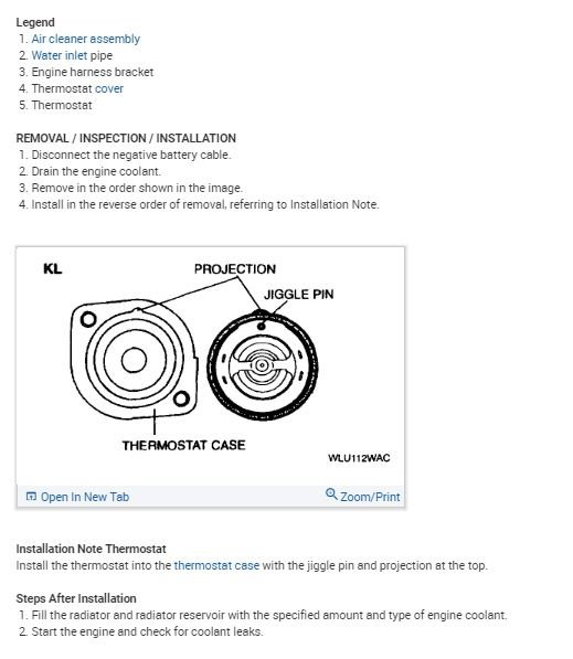

Where is the thermostat located on 95 millenia?
Monday, December 14th, 2009 AT 2:28 PM
BLUELIGHTNIN6
MECHANIC
16,542 POSTS
The thermostat is located on the right front of the engine block just behind the distributor
See the attachments below for pictures and instructions
Let us know if you need anything else
